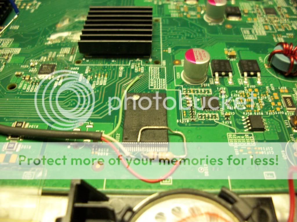

Here is a Picture of My Solder Job.....
on the RGH image, change the LDV value up by 1.
