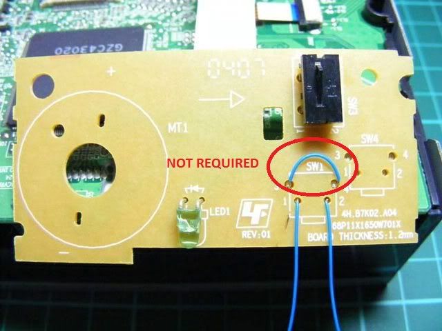

I used Smokeingit 4th tutorial, but found that a lot of the wiring mentioned is not necessary at all he has two switches presumably to power the drive on and off and one for eject mechanism. I left out the power switch and simply wired the eject.

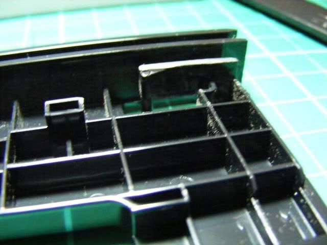

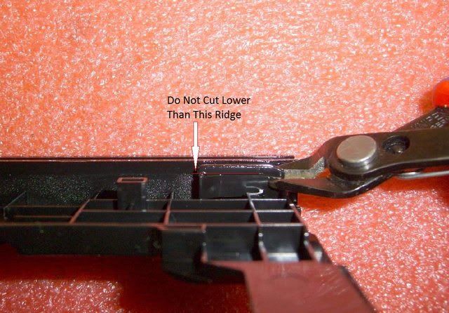

Step 1
Remove drive casing, tray bezel and front plate, eject tray and carefully lift tab to slide tray out of drive.
take the tray and flip it over and look for this little tab that stops the tray from fully ejecting out of the drive, its basically a little stopper.
use a dremel or cutting tool to carefully remove about 2mm from the top, there is a small line on the tab that you MUST NOT cut below or else the tray will end up ejecting right out of the drive. Aim to be perfectly in line with this little marker.
the above picture shows snips but i personally used a dremel with a sandpaper cylinder tool much easier IMHO
heres what is should end up looking like
tray ready!!

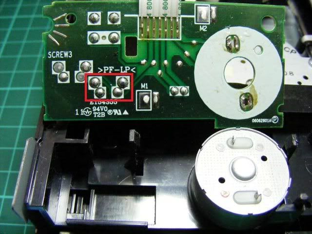

Now for the drive eject motor daughterboard modification.

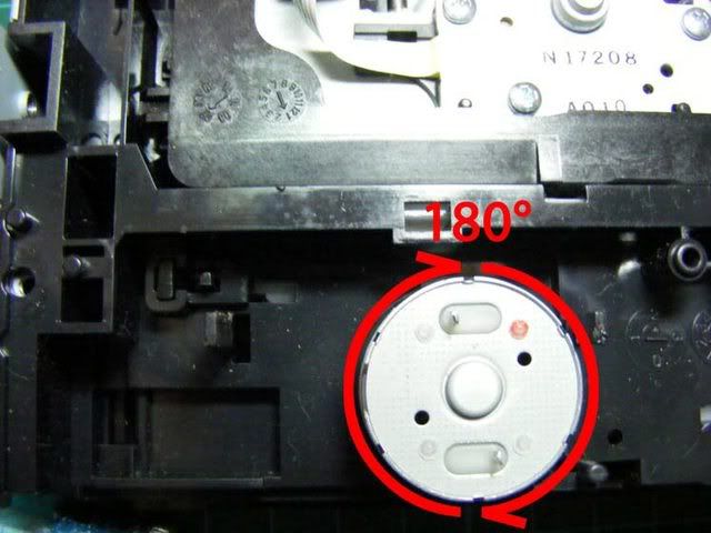

desolder the motor from the board using copper braid and be careful not to lift the pads (if you do, read on!!)
carefully rotate the motor 180 degrees good idea to mark the original position of the motor as a reference in case you get mixed up or the drive hits the floor etc!!
then you can remove the motor board from the chassis, should look like this
in the above picture, only the lower two pads are required, the top two are simply pads that connect to ground to attach the switch and make it solid there is no electrical function for these. The original tutorials show a wire joining these but it is completely unnecessary. mine does not have this wire and it works perfectly, why join ground to ground its already connected as its one massive ground plane!!

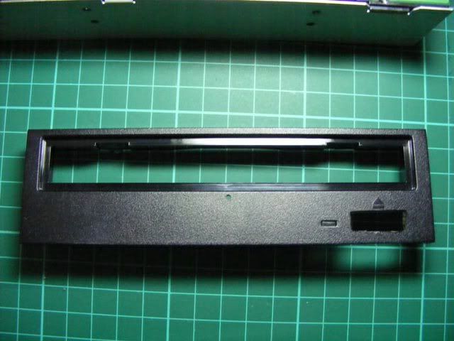

The wires then run to a rocker switch which looks awesome installed in place of the original eject button. Measure the dimensions of your switch and stick masking tape on the drive front to mark out the hole required and dremel it out. Takes a bit of time and patience to make it neat and tidy dont make it too big or your switch will wobble about.
