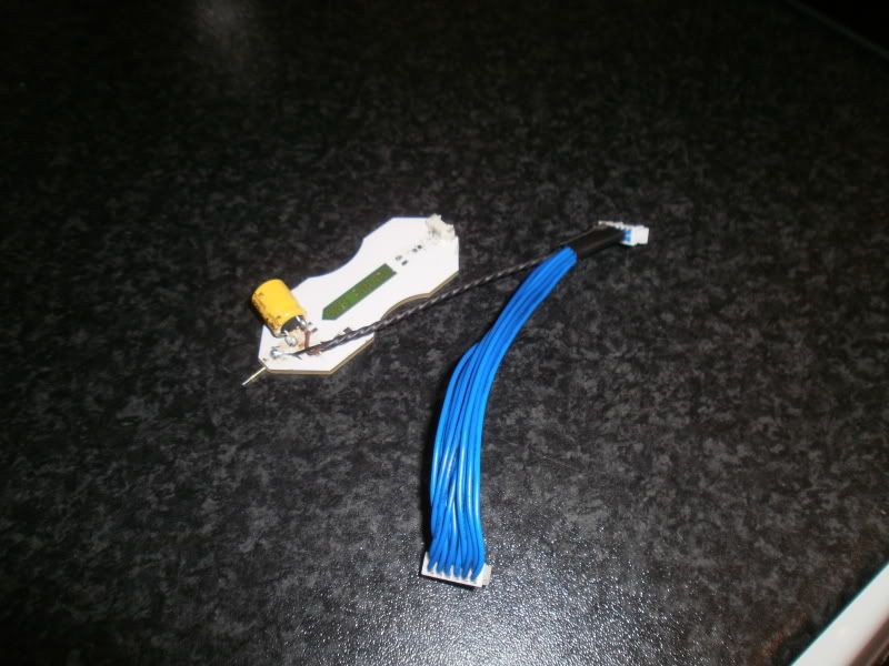

« Reply #44 on: March 01, 2011, 05:34:45 PM »
NICE!!
pic of my setup
got the cap from a dead 360 mobo, they are found around the GPU/CPU. 820uF and 4.0V rating.
first test got status 0x51, then 0x52 after applying probe.
removed probe and got complete message, power cycled the ck3, then to my horror got this message:
"Re-sending Vendor Intro:
Serial flash found with Status 0x52
Extracted drive key failed Verification !
PhatKey extraction failed!"
drive kept spitting same error over and over again no matter how many times i tried.
hit IRC and got guidance from Oggy about adding a switch to the 3.3v line.
soldered a switch into the 3.3V line (brown colour number 6 in pic below) following this guide:
now if i do this, paying attention to the 3.3V switch:
1. CK3 Main Power ON, 3.3v Switch ON
2. Press PhatKey, then Yes
3. 3.3v Switch OFF, connect GND wire to MPX01, 3.3v Switch ON
4. After "Extract Complete" disconnect GND from MPX01, CK3 main Power OFF. Wait 5 seconds.
5. CK3 Main Power ON, press OK.
6. Done!
success!!
cheers to Oggy, spudnutz, BoNg420, & TX
« Last Edit: March 01, 2011, 05:38:43 PM by Gazcoigne » Logged
