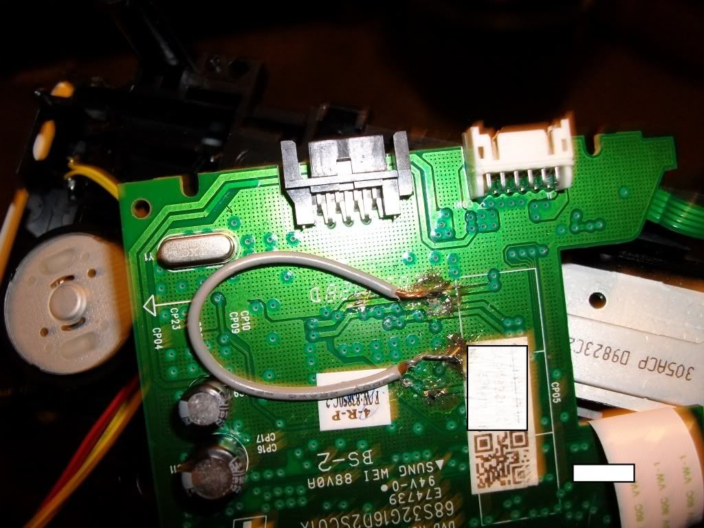

first you need to remove that wire, only expose just enough wire to solder to the board.  you want the wire to lay flat on the board when u solder it so pre shaping it is important.  basically, the same size and shape as the one in my pic is optimal.  after you think you are done soldering, take a multimeter and test all of your solder points to ground for continuity.  any current or past shorts can fry you whole drive beyond use.

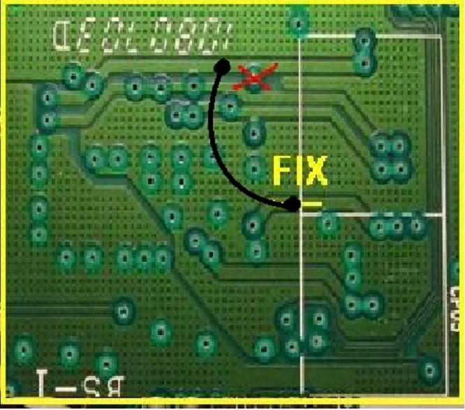

you can probe 122 alternatively.  you will need to leave the mra jumper on after flashing for the drive to work.

CLEAN THE PCB AS IN "A" AREA (brush pen?)
seems like ur cuts aren't deep enough
seems also your hand is delicate as king kong's
use a ruler to stop ur hand while cutting
after the cuts check with MM green points and blue points
(to check with MM you must expose the copper in those points and obtain no continuity)
then go,ask someone to do the solder job for you.

sorry for giving yall all a blanket answer, but pretty much all of you have just used to much solder.  u want to use the least amount possible to bridge cuts.  if there is a large gap then use a small piece of wire to jump it.  refer to some of the pictures int he beginning of this thread and when you see one with a clean solder job, make your stuff look like that.  be sure to use a multimeter to confirm that you don't have shorts before powering your board again or suffer permanent damage.  if you still can't figure it out, send me a pm if you are in the us and we can make arrangements.

that is way to much exposed wire.  you only want 2-3 millimeters of exposed wire when making these trace jumpers.

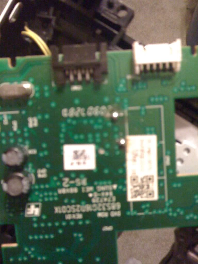

I think I fired my DVD by upside down power cable (Not sure about it). But I saw smoke just after I plugged power cable. I was following MRA hack. I do not see any fired part in the PCB.
Here r the pictures for both the side
http://img832.imageshack.us/f/side1y.jpg/
http://img687.imageshack.us/i/side2m.jpg/
I used XBOX as power source for the DVD. I powered XBOX with DVD plugged in when I had trace cut. As it fired, I do not have key. After the DVD fired I repaired the trace cut and tried to power the DVD. With DVD powered ON, I get 3 flashing red light. Without DVD the XBOX works.

« Reply #836 on: October 14, 2010, 06:13:19 AM »
those are both pics of the top, it doesn't look like you powered upside down, does the other side look like a bird $#!t solder on the pcb?
I have updated the link..
Here is it.
