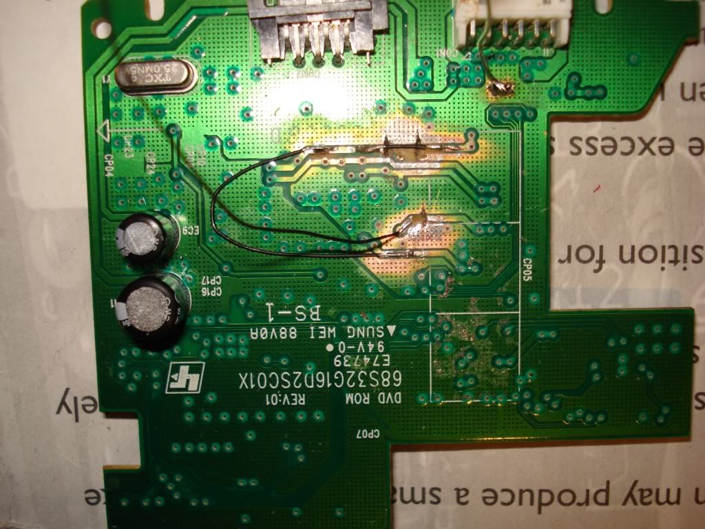

This is a pic of my soldering and wiring. I have tried a 20 and 22 ohm resistor and no luck just get 0x51 or 0x52 or when i power off i get 0xD2. I am power on with the console and the dvd drive ejects and the power light is constant.
any tips will be much appreciated i used a multimeter to check for shorts and couldnt find any
mvpv82
« Reply #681 on: July 30, 2010, 04:59:17 AM »
Quick update i changed the resistor to an 18ohm and now its fine however i cant read the firmware it keeps saying parse failed
« Reply #682 on: July 30, 2010, 05:02:31 AM »
The resistace is? Measure 3,3V to gnd.
Turn the switch off or take the resistor off when reading (after you have entered vendor mode)
mvpv82
« Reply #684 on: July 31, 2010, 02:25:51 AM »
Thanks guys all good now dump/flashed and tested with a dvd and all is working.
