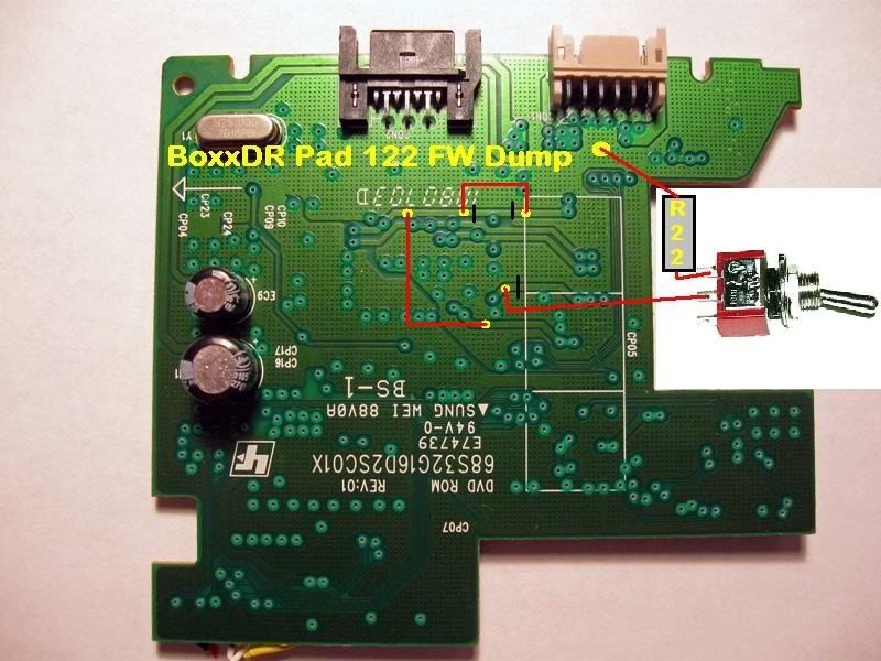

when i take the probe off and hit intro again it cycles back around it doesnt give me full vendor stats
« Reply #665 on: July 23, 2010, 12:33:32 PM »
Dont take it off Press the wight button, on top off probe2. What it does --> 3,3V to pad 122-->101.
What is your resistance 3,3V to GND?

remove the 122 jumper and probe 122 w/ 22 ohm resistor.

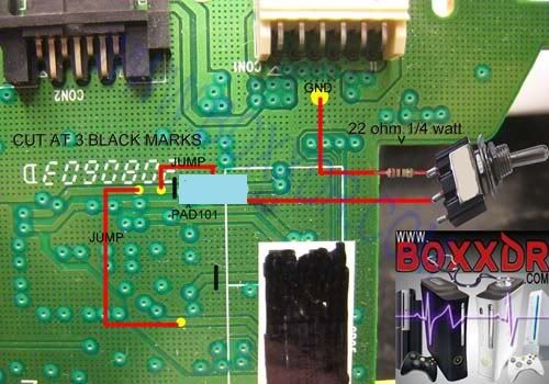

Hi there - I have attempted the boxdr method of modding my liteon but have destroyed the pad 101 now i can not solder the wire from 101 to the toggle switch.
Is there an alternative part on pcb i can use to attached another wire to the switch.
Highlighted blue area shows what i have destroyed. Also how will i return the board to normal after i dump/flash the drive.
Your help will be much appreciated mate

« Reply #679 on: July 29, 2010, 12:56:55 PM »
you can probe via 101 or 122 (122 is left of the lower cut).
once you blow that point, your only hope is under some epoxy.
make sure you have no shorts.  take a picture of your board if at all possible before you turn it on again.  powering on while shorted can do permanent damage to your drive.
