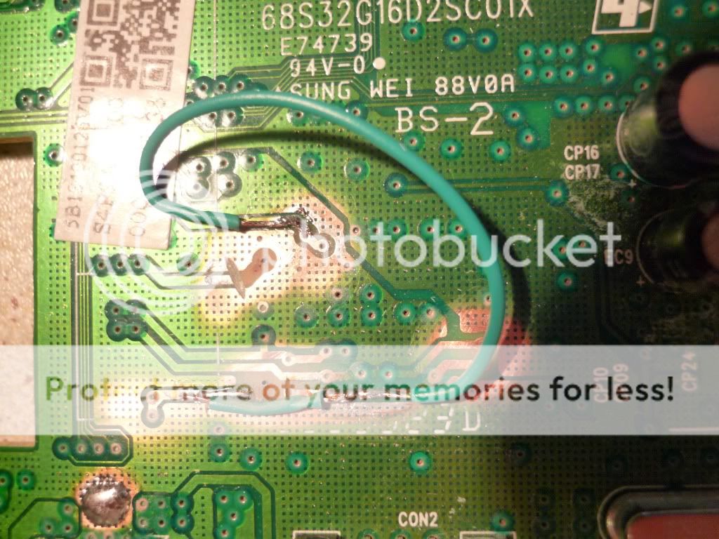

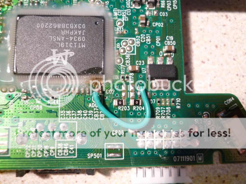

Now if i encounter this drive again, is it a case of just isolating pad 101 and 122 and using the probe ?...i have the jump wires on becasue i screwed the pads correct ?
Again..correct me if i am wrong..now the drive is flashed, i DONT remove the jump wires i have on as they are to reconnect the pads..and in which case i do not need to try to repair the cuts i made ?...so my board should look like this before i replace it on the drive...

« Reply #373 on: May 11, 2010, 05:08:14 AM »
Install jumper wire, R207 0 ohm resistor to pin101 capacitor. (this will fix your broken pads 101/122)
The other jump wire in the pic is same as your upper jumper --> Jumpwire: R207 0 ohm resistor to C03.
Or just do it like in the picture. Last measure 3,3V to GND.

« Reply #376 on: May 11, 2010, 03:46:00 PM »
Hows this looking ?...i warmly accept any criticisms....
I will test the ground now...fingers crossed...
« Reply #377 on: May 12, 2010, 12:11:27 AM »
loady,
I am using awg30 wire and flux. Your work is normal beginners soldering.
