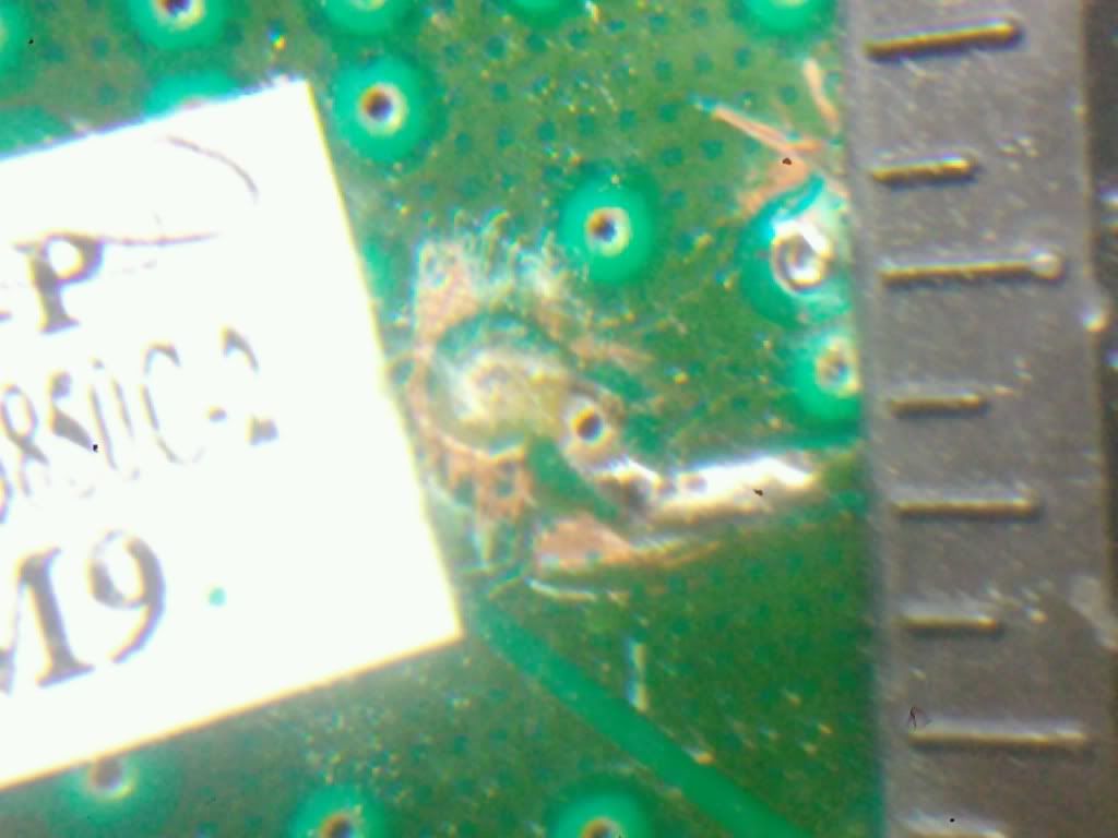

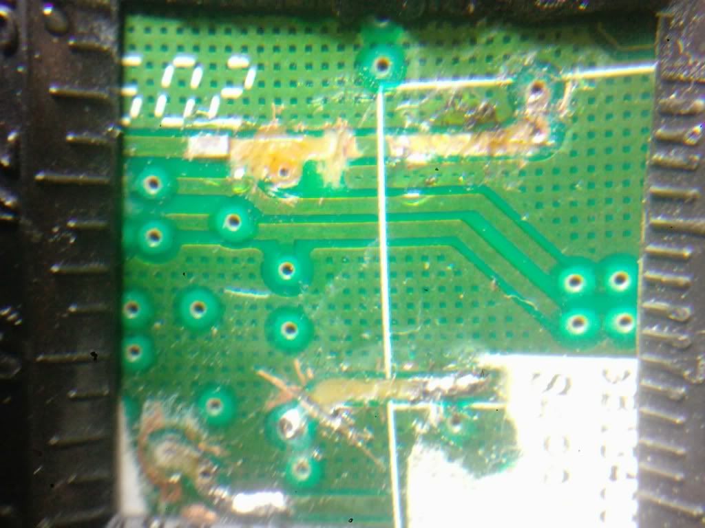

Egooo
« Reply #330 on: May 05, 2010, 10:47:47 AM »
Welcome
 I have the problem everything can be seen in the photo, wat now? As lead cable ?
http://wgrajfoto.pl/pokaz/img0510/p5022902small97f0.jpg
But I upload on the web page does not act sorry
teajunkie
« Reply #331 on: May 05, 2010, 02:37:33 PM »
Looks like you have cut through a rail.
Check the red boxed area for a break in the trace.
« Last Edit: May 05, 2010, 02:39:53 PM by teajunkie » Logged

that is not the problem, he lifted 101 and it looks like the trace patch job there is botched.  rejoin that trace that is severed in half and then put the 3.3 jumper line back in place and your drive should work so long as u didn't fry anything out.
« Last Edit: May 05, 2010, 09:26:58 PM by iateshaggy » Logged

Egooo
« Reply #337 on: May 06, 2010, 08:51:22 AM »
The problem is the pad 101  {red box Is ok }
This means that only one breast? There is nothing more?
But where I combine this point that read off the key?
http://wgrajfoto.pl/pokaz/img0510/image19877c.jpg
« Last Edit: May 06, 2010, 09:42:00 AM by Egooo » Logged
