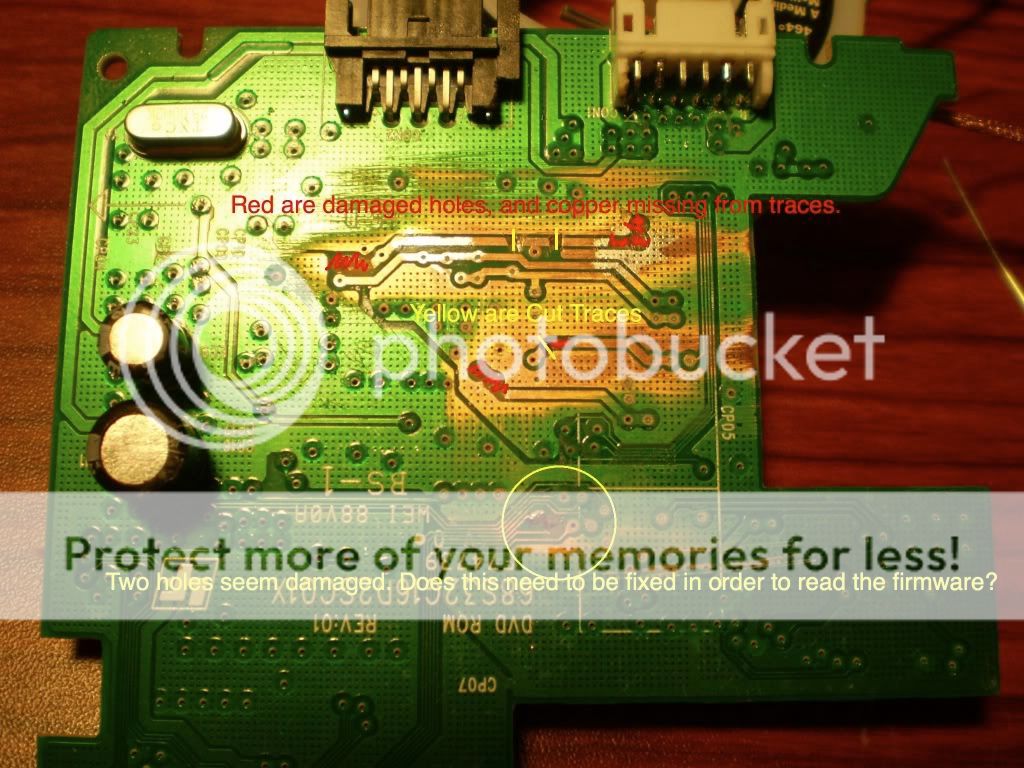

OK Dream. I apologize, but this is what I have after cleaning it up a lot. I tried your wiring method but unsuccessful. Here are updated pics. Please notice the traces damaged below.
I just need to read the drive, if i can fix it that would be great. I tried to read your diagrams on pages before but seem 3.3v is not coming in from pins on the top right so it wont work. Any illustration would be greatly appreciated. Thank you dream!

CatchThaBeat
Posts: 42
Find me on the scene.
« Reply #497 on: June 16, 2010, 11:35:17 PM »
« Last Edit: June 17, 2010, 12:45:14 PM by CatchThaBeat » Logged
« Reply #498 on: June 16, 2010, 11:42:10 PM »
CatchThaBeat,
I don’t won´t to see this end up to recycle bin. Send the board to me. I will fix it for you.
CatchThaBeat
Posts: 42
« Reply #499 on: June 17, 2010, 12:51:34 AM »
CatchThaBeat,
Dream please, I know you could do it but Id like to myself. What ALL must be connected to just pull the fw?
