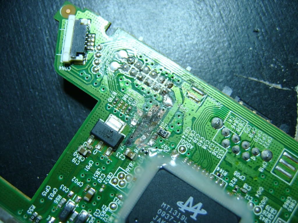

A friend sent his xbox to me for a firmware update. I flashed it back with the old MRA hack, and as you can see, I did a nice job on the soldering, so I'm not a soldering retard. However, I'm thinking that the owner probably tried to update the drive himself from the looks of things. I'm guessing power was plugged in upside down. Any suggestions on a fix? Or can I send the board to someone to grab the drive key for me? I cleaned up a bunch of the solder on the face of the board. It was pretty bad.
Thanks, guys!
(Yes I'm willing to pay :p)
ttz
Posts: 28
« Reply #1214 on: November 30, 2011, 05:59:32 PM »
this guy (liar) told me he did nothing!
I don't need csi miami to know what he did and he also tried to fix it
He has the key and the 360 is ready to play again (with another liteon) but i'd like to fix this pcb
hints? (i saw how to fix in previous posts but this pcb seems in a worse situation to me)

« Reply #1216 on: November 30, 2011, 08:18:21 PM »
its not worth fixing once u have the key.  there are plenty of phat liteon boards floating around for 0-$10.

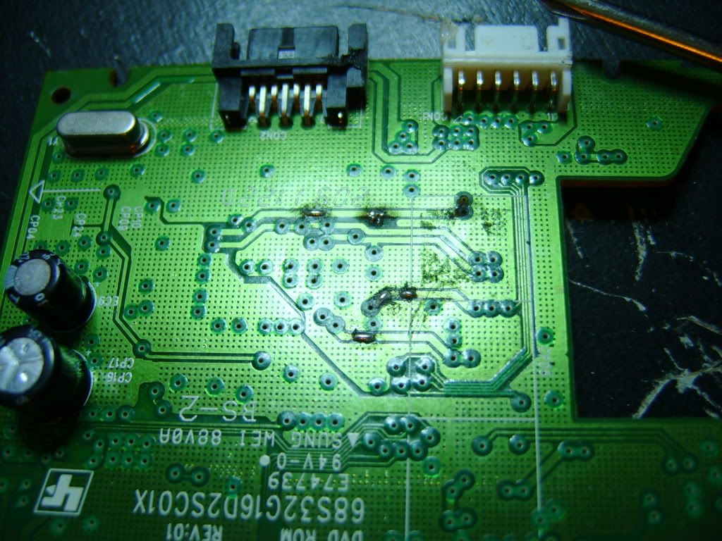

« Reply #1218 on: January 19, 2012, 10:42:36 PM »
Excuse my English
was a reversal cable, which apparently does not present anomalies in the plate, Exeter voltage regulator q towers =]
I have sinned in the same regulator had another liteon here, and yet nothing, with the help of a multimeter realizes that he is getting voltage at the point CO3.
PS: when you change the regulator, I corrupted a track very close to him, that when I took the test I performed a jump.
if help, follow the picture of him:
http://imageshack.us/photo/my-images/694/cpiadep1090058.jpg/
http://imageshack.us/photo/my-images/854/cpiadep1090066.jpg/
http://imageshack.us/photo/my-images/851/cpiadep1090067.jpg/
have concert?
« Reply #1219 on: January 20, 2012, 07:23:51 PM »
undo shorts and do the exact same thing as the one in the very first post.  a better picture of the underside would help.
