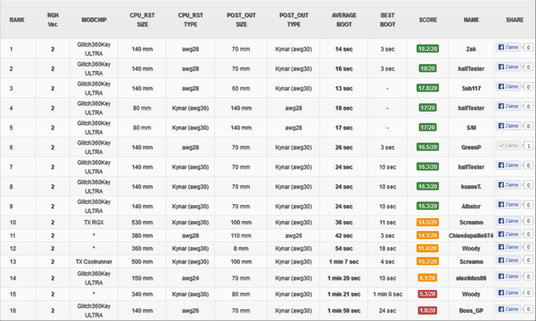

Nice work! happy to see poeple are having the same idea Cheesy, also using the uart to log the boots of the xbox is easy and only require 2 wires for the data and 2 wires for turning on and off the xbox
We've been using this feature with the Glitch360Spi 3.0 rev B for a long time, we also made a Benchmark using our programmer in order to log boots of an xbox using the uart.
You can find all the informations about eRGH Benchmark here: http://glitch360key.fr/en/ergh/
Our benchmark waits either the xell or freeboot to load and will log each time as a sucessfull boot
Poeple using our benchmark can then share their glitch setting and upload it on our online cloud (http://cloud.glitch360key.fr)
Other members can then consult the cloud
Then find the best glitch settings for their motherboard and modchip
