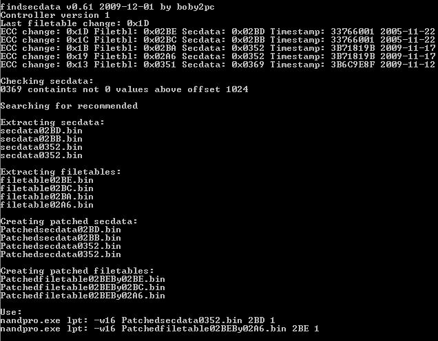

Can somebody point me in the right direction? Does this mean I have a chance of restoring my ability to install games to HDD? I am a newbie I manage to get a friend do the LPT cable for me and this is the result I get with findsecdata. What I don’t understand is the commands when it tells me to use:
nandpro.exe lpt: -w16 Patchedsecdata0352.bin 2BD 1 DO I press ENTER here or I have to wright the other command?  Huh
Nandpro.exe lpt: -w16 Patchedfiletable02BEBy02A6.bin 2BE 1
I am sorry if this is a stupid question, I just want to learn the correct way before doing anything.
Thanks in advance.  Roll Eyes
« Reply #369 on: December 07, 2009, 05:50:20 PM »
you press enter in between.
Sorry, it won't work, because Your real unbanned secdata.bin at block 369 is overwritten.
You could send patch to reverse to secdata.bin at 352 but it's banned one.
