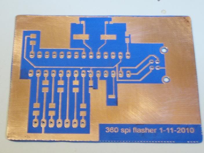

bigfish58
Posts: 27
« Reply #585 on: January 13, 2010, 02:00:38 PM »
The final PCB;
Hopefully should get this made tomorrow Cheesy
« Last Edit: January 13, 2010, 02:04:04 PM by bigfish58 » Logged
SpikedCola
Posts: 44
« Reply #586 on: January 13, 2010, 02:43:14 PM »
If you relocate the parts and add a ground plane, you can make the entire board single-sided, with no jumpers Smiley
