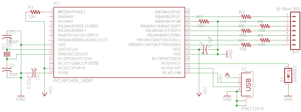

Here are the Eagle schematics and board files to build the SPI only version. Feel free to modify as needed.
http://uploadmirrors.com/download/1W35QVSE/Xbox 360 Mini USB SPI Flasher.zip
Note: This version uses a real crystal.
EDIT 2009/11/26 - UPDATED PARTS LIST (Some of the parts were out of stock with no scheduled restock.)

EDIT 2009/12/11 - Board Photos
