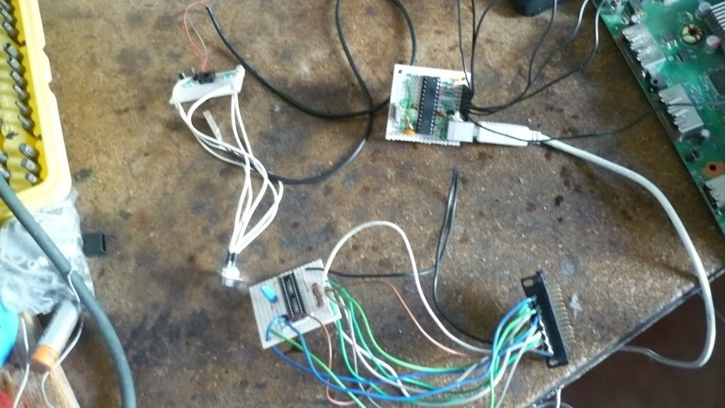

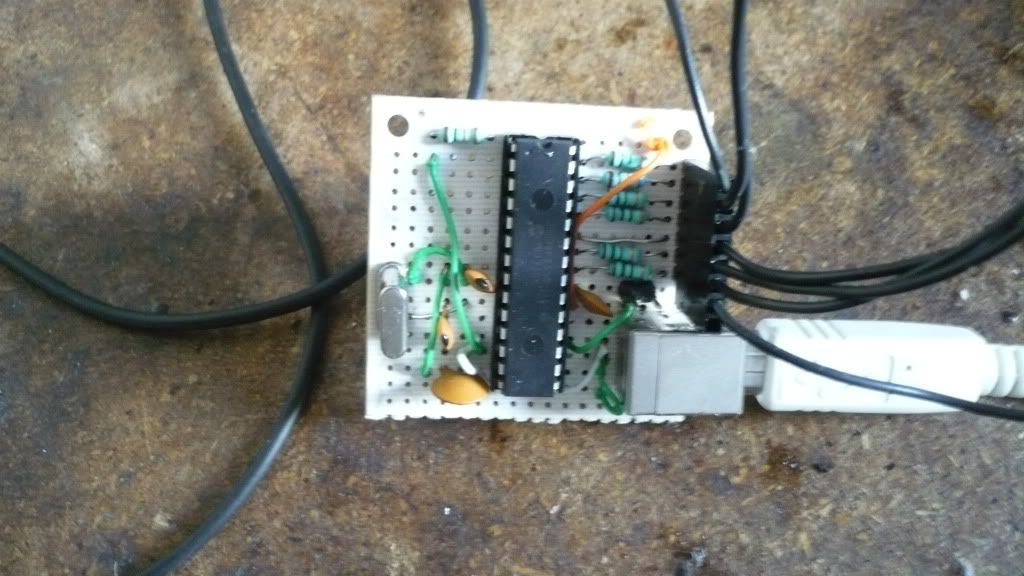

Hi .i build this flasher but first time when i connected to my computer it remain in bootloader mode then i flashed with v3complete and the same problem.today my flasher isn't reorganized by my computer.I replace the resistors the caps and same thing it no appear,no sound, nothing. Embarrassed  what can i do.please help.I changed 12 mhz rezonator with 24mhz crystal and nothing works.i checked the voltage on pin 13, 20,1 and is 5.07 v  but at conector for jtag  i have 2.50 v .
please help.
sorry for my bad eanglish
please help.
Any picture from your flasher? Did you remove boot mode jumper? It is better to use 12MHz crystal because it is default.

« Reply #1109 on: December 27, 2011, 10:48:43 AM »
yes i remove the jumper,i try with 12mhz resonator and now windows not detect any device.
some pictures
http://imageshack.us/photo/my-images/36/27122011012.jpg
http://imageshack.us/photo/my-images/210/27122011013.jpg

it is possible that pic may be damaged?
please help.
« Last Edit: December 29, 2011, 04:23:40 AM by vladccc » Logged
« Reply #1111 on: December 29, 2011, 05:47:17 AM »
It's possible that the USB part of the PIC is damaged, the rest of the PIC will still work then.
vladccc
Posts: 7
« Reply #1112 on: December 29, 2011, 08:58:04 AM »
i can program the pic but my pc dont't see it.how can i know that pic is dameged?
