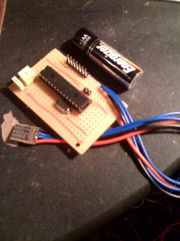

« Reply #919 on: June 03, 2010, 07:48:07 AM »
just thought id share my little DIY one built on protoboard.
she works like a charm, 16mb dump in just over 5 minutes. ive done 20+ jtags with LPT and finally got around to building one and i wish i did it sooner.
ill share the parts i used since i know this works first time like a charm and some people ive read had issues with the caps and crystal specs.
im using a 20mhz crystal with 2 10pf caps off it, 100nf pictured in the top corner across the 5V & ground, three caps in parallel 2x 100nf & a 22nf going to pin 14. all resistors are surface mount and on the underside of the board same with the 2 10pf caps. It was made with parts i had in the parts box hence the caps in parallel and the mcguyver'esque usb made of spare protoboard
big thanks to darkstar and all the pages of reading of reading on this topic that helped me get it right first time.
is there a donate link or what not to darkstar? if knowing is half the battle i wouldnt mind donating half the cost of what a maximum usb reader would have cost me to him.
