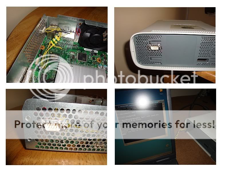

gyte looking at your pics more and more... i dont mean to sound like im bashing you bro but it looks very amateurish. that ide cable or w/e it is is NOT proper. get a ethernet cable cut it up and use the wires in that. atleast it will be shielded all together. plus depending on the brand of wire it will be copper which is REALLY good for transferring of data.
Uhm, what kind of conductor is used in ide cables?
And as Blackaddr pointed out:
UTP= Unshielded Twisted Pair (default network cable)
STP= Shielded Twisted pair
And could we please have some hires pictures of your setup?, i want to make the next xbox mod as nice looking as i possibly can...
max im at work till 7 wont be home till 7:45 est when i get home il take pics of my setup and post them on here.

Error: 258 reading block 153
Ok, Your setup looks pretty solid, no obvious errors(have seen repair jobs by proffesionals that are far worse Smiley ).
Some tips:
1. Use J1D2.6 or J2B1.12 for the GND connection
2. Use single strand wire(solid core), less problems with single strands shorting something
3. Use heat shrink tube
4. Polling off
5. All programs closed while dumping, no Antivirus, NOTHING!!, pull out the internet cable(UTP Smiley ), check pc for spyware/virusses first etc, remove scanners etc.
6. if no printer installed please install a text only printer driver on lpt1 and reboot, else remove the printer driver from lpt1.
7. Use slightly smaller resistors eg. +-82, then +-56 (you can probably use 1/8W without problems(smaller in size)
8. Make sure there are no forms of electrical interference present, no fridge that powers on or wifi routers laptops etc., mobile phones etc, you get the idea.
If you compare all the dumps that you made do you ever have the same error in the same place?, and how many dumps did you make?, are there differences outside the FF area?
Differences in between 0x642600 and 0x64680 you can ignore as said earlyer.
If you compare FF to BF it is only a 1 bit error...
Maby Tiros or someone else could answer me this, are all the bad pages in NAND mapped out beforehand or are they marked bad if they are detected while writing/verifying(during update)?
As the NAND can wear out over time, some form of correcting mechanism should be in place (in conjunction with ECC)
This really is a difficult one, i hope a new cable setup will cure the problem but somehow i think something else is causing it (really hope not)
