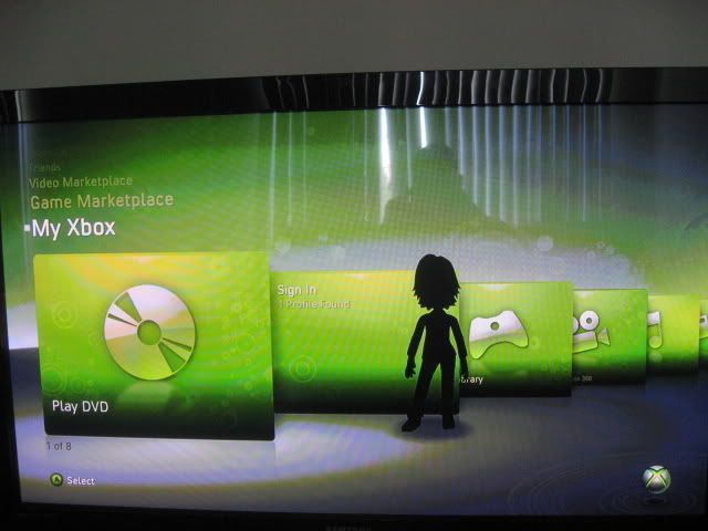

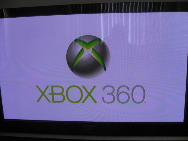

Description of my xbox 360 issue:
My 360 will not play any games but will play dvds. And it will play downloaded game demos off the hard drive. But no games from a disc. My xbox has not red ringed. And it seems to stream fine through tversity. So seems like it's a drive issue.
When a game disc is in the drive but not launched the drives says "play dvd."
When I attempt to play the game the xbox 360 freezes on a white "xbox 360" logo screen.
