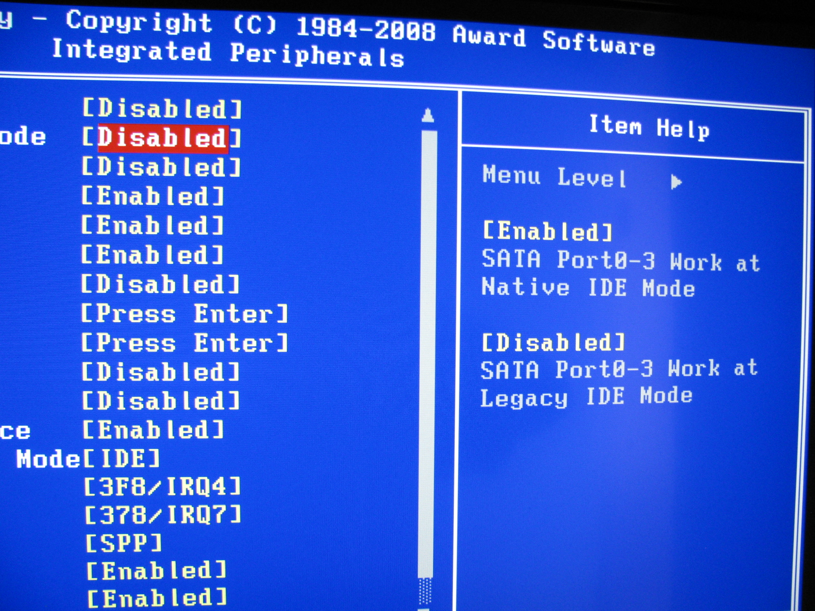

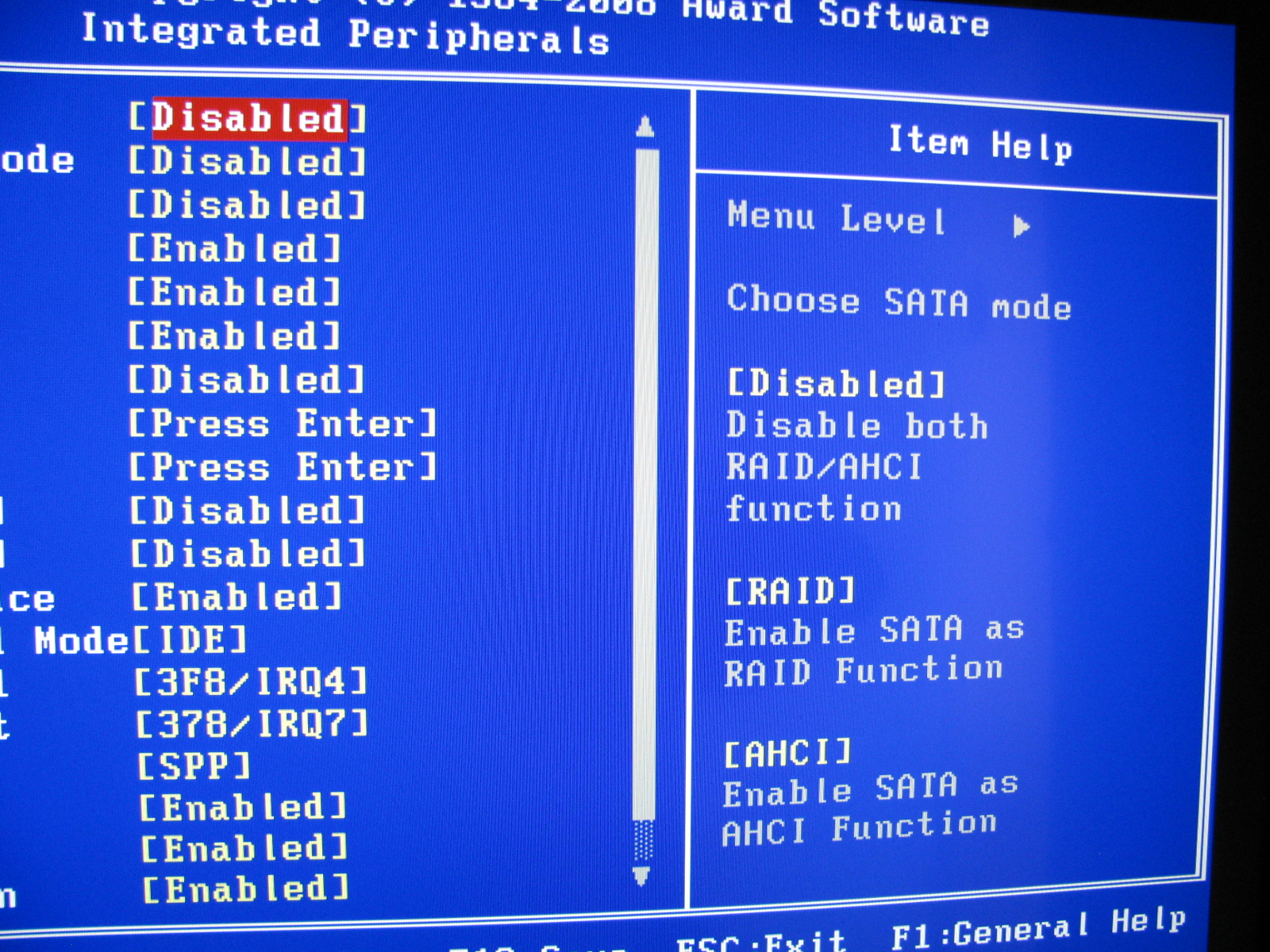

the xbx dont recognize the disk.. i mean after all, i go to the memory menu and nothing, no disk
My motherboard is Gigabyte EP45-UD3P
Disk
Bios Options
First i use the hddhackr and works perfectly, like in the tutorial, work perfect
after that, turn off, wait 10 second and turn on and turn off to remove the disk
Then i put the disk as slave because (using a sata cable and a sata power connector) so i try use that program "Xplorer360 Extreme" for restore the partition2 of Xbox 1 Emulation
So when the computer go in windows, i see a pop up message "installing divice drivers" i dont know if that drivers was installed in the main hard disk (my main computer disk) or in the hacked 250gb drive, also the drive dont appear in "my computer"
So i open that program fallow the tutorial and it let me restore the partition 2 (i download it from other forum).. so the program can detect the drive and windows not? and it take a few seconds.. then i shutdown the computer, remove the disk and put in the xbox and the problem begin.. there is no hard disk in the memory menu, but i feel the disk working, i mean i touch it and is On
After read a little i restore the firmware using the Undo.bin backup, i DONT know if this remove the previous partition 2
and i supose the hard disk is as the start
And hddhacrk again..

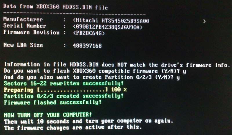

when i use the hddhackr, all work perfect, exactly like this picture
then i turn off the computer, wait 10 second, turn ON, wait a little... shutdown again and remove the disk
i shutdown the computer with the power button, because there is no command in hddhackr to shutdown the computer..
then i connect the hard drive to the xbox360, go to the memory menu, and nothing, no hard drive
Maybe is problem of the hddss.bin, because is from 2009, and the actual drive are 2010
EDIT: Solved
My Motherboard ICHR10 Chipset create a security sector modifing the original LBA of the Hacked Drive
This happend when u turn on the computer for second time, ex:
Turn On for use the hddhacker, then it ask you turn off the computer, wait 10 second and turn on again (second time)
So during the POST of the second turn on, it create the security sector and u get owned XD
Solution, when it ask you turn off the computer, do it and remove the the hard disk... dont wait 10 second and turn on
