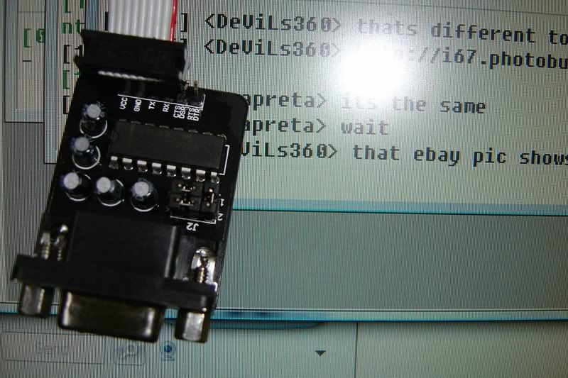

« Reply #460 on: September 13, 2008, 10:01:04 AM »
Ok guys,
I now double checked everything again, reversed Rx Tx cables to the powersource of the drive,
resoldered the two points on the drive, tried the paper clip method and the connectivity-kit method
to open the tray,but no luck - I'm still only recieving the INQUIRY.bin and IDENTIFY.bin, but no Key.
Error is, again,
Sega:54
COM port seems to work anyways.
The interesting thing here is that its always that error, even with reversed Tx/Rx.
Well, I 'm gonna try the DVDKey 32, but maybe someone could point me in the right direction here,
as I'm slowly loosing my mind with this piece of sh** drive....
I'm having the EXACT same problem. I can get the inquiry.bin and identify.bin but no key.bin. It give the error "Sega:54 ....COM port seems to work anyways" I am getting the same result with rx/tx swapped either way, which is strange as I can get identify/inquiry.bins no matter which way I set up rx/tx.
It could be the half tray closed thing, as I can not get the drive to power up and have the tray stay half way open. I am using the 360 to power the drive, here's what I've tried and the results:
-disconnect SATA from drive (just power cable from 360 connected, MAX3232 soldered on), turn on 360, eject tray, close tray, power off 360, use paper clip to eject tray half way, power on 360 => Tray closes!!!! Argh!!!
-disconnect SATA from drive (just power cable from 360 connected, MAX3232 soldered on), power on 360, eject tray, close tray, pull power form 360 before tray finishes closing, power on 360 => Tray closes, Argh!!
Also there are some jumpers on my MAX3232 dongle, I have just left them as is. There is a pic below. Does anybody know what I should do with these?
Any help would be greatly appreciated.

Posts: 39
« Reply #461 on: September 13, 2008, 11:29:59 AM »
jumpers don't work for this method!!!      just invert the tx and rx and it will work

two-rok
Posts: 20
« Reply #463 on: September 13, 2008, 12:00:19 PM »
Ok guys,
Error is, again,
Sega:54
xboxchan, how did you solve your problem? i have the same adapter as that one on the picture, i'm also only receiving inquiry/identify, but no key.bin
tried all different kinds of ways, jumpers as it came with, without jumpers, rx-rx & tx-tx, and inverted rx & tx
the 2 bridges are properly done
what should i do? it's weird that so many people have the same exact problem (i think you did have this problem a few days ago too), how did you solve it? i think i remember you saying that inverting tx&rx didn't make a difference, just like me
swiftb0xar
Posts: 10
« Reply #464 on: September 13, 2008, 02:02:08 PM »
Hello again,
@XPunked
Seems like you can't really get the Drive in the right mode,
try to not power the xbox itself down, instead leave it
running through the whole process, and only manually disconnect
the power cable to the drive itself - at least that did work for me until
I got my connectivity kit 2, thou
Greetz

I am convinced it is the MAX3232 dongle. So I've ordered another one from eBay (below). Can anyone confirm that this one works?

For key retrieving, you need a LVTTL-RS232 converter (max3232 with 3,3vcc)
max232 with 5vcc seems to do the job anyway, i've not tested, but a safe way it's to connect only the RX line of max232.
You must use COM1 embedded on motherboard (0x3F8 IRQ4)
1 Poweron drive, eject tray, poweroff drive, close eject switch, manually close the tray to halfway.

For rs232 troubleshuting, consider that Liteon  by default outputs an endless stream of 0x00 and 0x01 at 115200 8N1, you should see it with Realterm with display set to hex
Seems most people having problems did not read carefully the readme.
For the inquiry.bin hang, are you all using FreeCom dos? What's the sata controller? Try MS-DOS
For the people with "COM port anyways seems to work", try Realterm on windows to see if the converter receives the stream of 0x00 and 0x01
I have one of these and it works like a charm.

As asked by Devils360, here is how mine is working:
Yes I noticed on the ebay pic everyone seems to be having trouble with that the jumpers are set differently to how they should be
now they seem to ship with this config 1-3 2-4 5-6 but they need to be set to 1-2 4-6 3-5
hope this helps you guys
